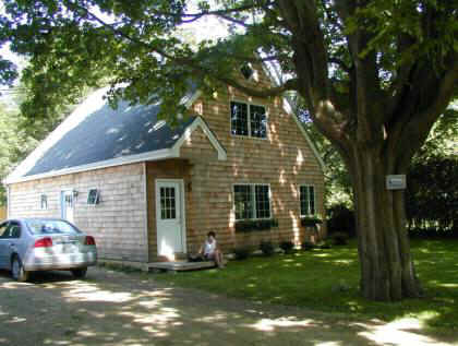

The house below is one of our best examples of this approach. It's a perfect rectangular plan of almost 1500 square feet, 32'x28' with no dormers on it's simple roof. The general contractor had the last SIP up and foamed in by lunch on the second day, including the framing and installation of the second floor. The foundation and first floor deck were down and backfilled ready for him to begin. A few other details are of interest:
  • The first floor was "inset," that is, hung from the sill plate with top-mounted joist hangers so as to allow the finish floor to come closer to the finish grade than usual, and to eliminate the pesky detail at the edge of the first floor where either the wall panels extend down past the floor framing or some other kind of time-consuming detail is required to insulate and seal this connection.
  • The wall panels and roof panels were 8 foot wide "jumbos" which eliminates half the joints required by 4 foot panel width layouts.
  • The panel-joint-over-ridge-beam, which can be problematic to install and seal properly, was of the overlap variety, rather than the miter type.
  • A crane, which was necessary for the roof panels anyway, was there ahead of time to be used to help with the wall panels.
All in all, this was a textbook case of economical design and planning by the general contractor, which helped to really control the cost. I can't imagine a stick framing crew coming close to meeting - let alone beating - this schedule. One of the great under-acknowledged features of SIPs, is the elimination of most headers over doors and windows. Much labor with stick framing goes into laying out all the openings and fabricating all the headers.
Susan's house was done in no time, she beat the price of a "modular" and certainly had an envelope that would out-perform that of a modular by a factor of two, thus saving her money every year for the life of the building.

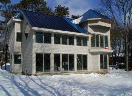

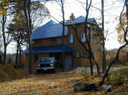

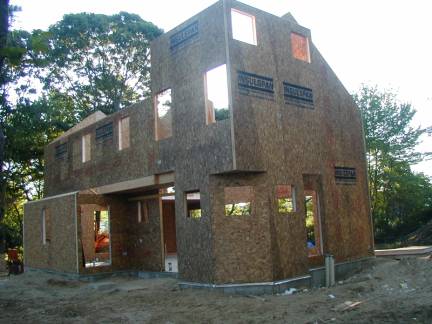

If we go in the other direction, Malcom's house -- also just under 1500 square feet of floor plan - has such features as turrets (yup, two of 'em), double height living room, a "bridge," two and 1/2 baths, and a second floor deck. The floor plan was very irregular, with several 45 degree angles. Take a look at the construction photos for this job:
The turrets, one square and one octagonal, were pre-assembled on the ground and then lifted into place with a LULL. They fit very well and could be foamed, sealed and screwed into place with very little adjusting.
The multi-faceted roof design was difficult to design and get into place, but it was a whole lot easier that getting the same geometries with sticks! Structurally, it was superior, with each turret structurally independent. As much as this was a far cry from Susan's house and required much more assembly time, I believe that the relative time saving over stick-built was greater with Malcom's little Victorian than with the KISS building. Most of the time spent building a complex shape with sticks is not in the cutting, but in the laying out of all the lines for cutting. A complex roof with many compound cuts can really eat up the clock, while with SIPs, all the layout and cutting has been done by the fellow who works out the fabrication (cut) drawings and the CNC machine or professional crew in the SIP factory. Assembling a compound miter of two panels is almost as simple as assembling a simple 90 degree corner.
