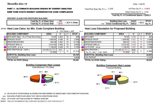

Below is the standard spreadsheet we use in our office on the construction documents for A) demonstrating Code Compliance, and B) for sizing the HVAC system. It is also very helpful in deciding, for example, whether or not to bump up the SIP walls from 4 1/2" to 6 1/2" or upgrade the windows.
The table on the left side shows a "code minimum" solution. The idea being that if we propose a building with more glass than the allowable 15% of gross wall area (New York State Energy Code requirement) we still have a compliant scheme as the total BTUH loss is still less than the total of the Code Minimum scheme. We can see that that is in fact the case here; in spite of the glazing accounting for 22.4% of the gross wall area, the total for our building is well under the allowable - 37 1/2% under!
A big part of this is the infiltration. Or example has a volume of 21,600 cubic feet. A code Minimum building has an ACH rate of 1.0. This is what I believe is built in to software programs like ResCheck, but is not available for confirmation or modification. Our example therefore has an air change rate of 360 cfm; this translates (cfm x 1.08 x delta T of 70) to 27,216 BTUH. With SIPs, we cut this down 60% to 144 cfm for a total of 10,886 BTUH. How and why do we do this?
