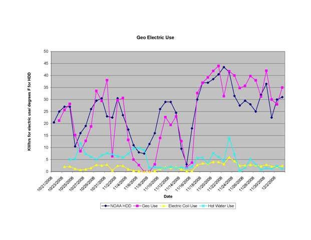

Here is the data from my 3 ton unit from last year.  As you can see, in my situation, the KWh usage tracks the HDD fairly consistently.
Attachment: HDDsmall.jpg
Ona

Thank you very very much, excellent data

Posted By Ona on 11/19/2009 11:58 AM
From what I see of the graph this appears to be a 43 day peroid.
If you have data for the whole heating season I would be very interested in seeing the graph or perferrably the raw data and the installation location so I could do an analysis.

retiredeng: I tried to send a reply with my raw data in excel format as an attachment, but this system does not allow that. I could not PM you the info either. Not sure how to get you the raw data, but I am interested to hear about your analysis.
